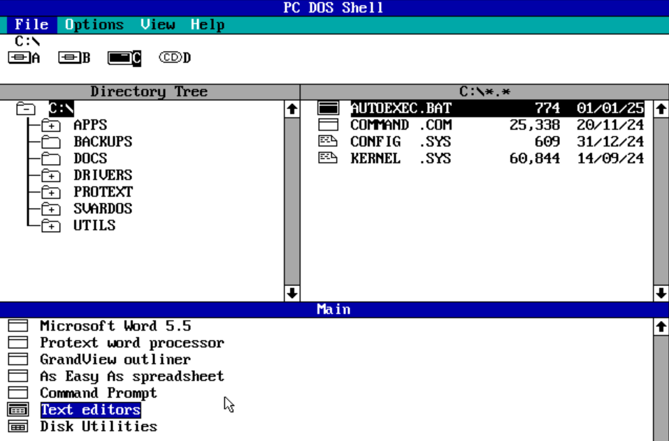

SVARDOS-USB-BootStick mit einigen Text-Editoren:
ZitatAlles anzeigenDOS live USB images with tools for writers
This repo contains downloads of compressed disk images of bootable USB keys.The first release is based on several upstream FOSS projects, plus some ancient DOS freeware applications. The idea is to provide a distraction-free writing environment.
It intentionally does not include tools to read or write NTFS or Linux disks, nor a network stack. To get your work off the key, just insert the key into a computer running a more modern OS.
What it contains: SvarDOS plus a menu launcher and a choice of freeware writing tools
The operating system is SvarDOS, the latest release as at end 2024. This version uses the kernel created by the former DR DOS Enhancement Project, in a slightly updated build using a simpler toolchain built by E C Masloch and packaged by Bernd Böckmann.I have built a fairly minimal installation, with the JEMM memory manager, FreeDOS text editor, CD and mouse drivers, and some simple diagnostic tools.
It has a simple launch menu using the DOSShell menu from PC DOS 2000, which back in 2021 I made into a Virtualbox VM and blogged about here.
The apps it contains are:
Microsoft Word 5.5, distributed by Microsoft as freeware as a Y2K fix
The final freeware release of the once-popular ProText editor
The WordPerfect Editor, a plain-text editor which uses the same keystrokes as classic WordPerfect 4.2
(These three from the FreeDOS Repo);
Symantec's GrandView outliner, thanks to John Faughnan's page
The Lotus 1-2-3 compatible AsEasyAs spreadsheet, by Trius Inc.
Protext is installed in the root directory, in C:\PROTEXT. The other applications are in C:\APPS. There's a C:\DOCS directory for your files.
guidol schönes Image. Wusste gar nicht, dass Word für DOS Freeware ist. Nettes Feature der DOSSHELL ist übrigens die Taskswitch Funktion mittels ALT+TAB, wie von Windows aus gewohnt. Kennen viele nicht. Leider hat's SvarCOM 2024.8 mit in das Image geschafft. Ich habe Liam geschrieben, dass er das besser zeitnah durch 2025.0 ersetzt, wenn wir es denn in den nächsten Tagen schaffen das freizugeben...
