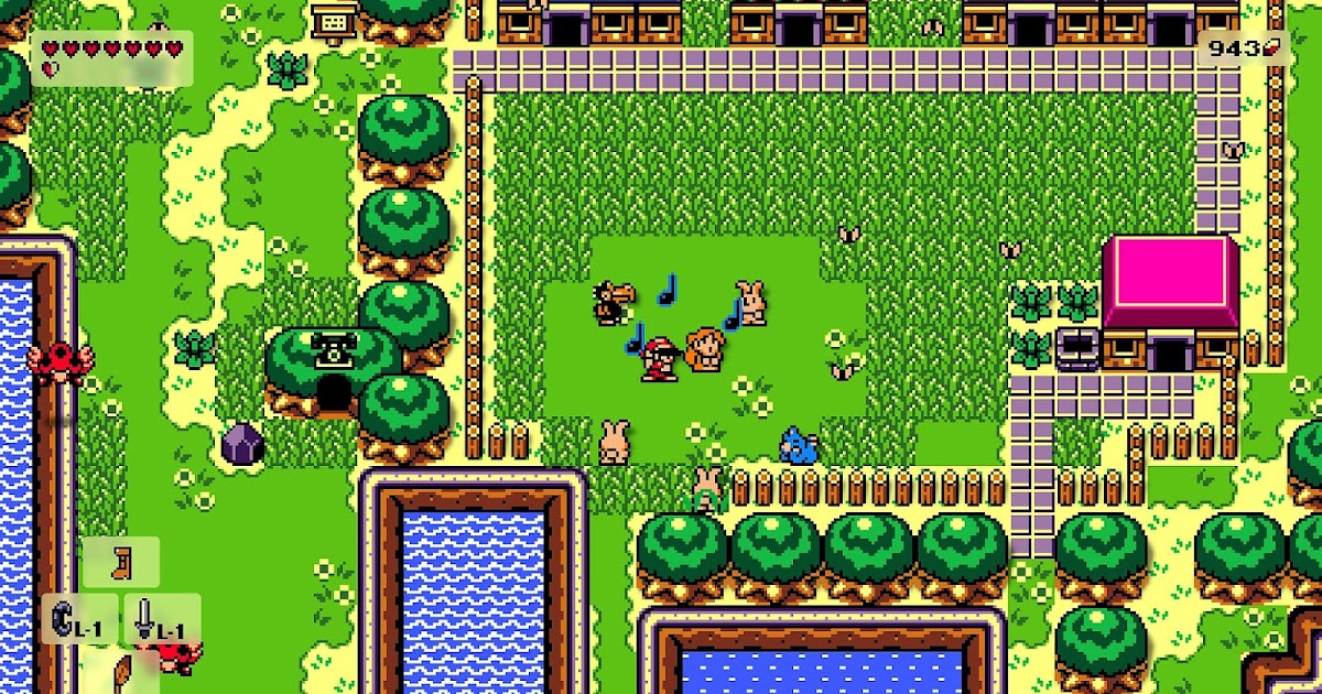

    Link's Awakening DX HD - An unofficial PC remake that breathes new life into this classic Game Boy Color game from 1998
    Link's Awakening DX HD - An unofficial PC remake that breathes new life into this classic Game Boy Color game from 1998!
    Link's Awakening DX HD - An unofficial PC remake that breathes new life into this classic game!
    www.indieretronews.com
    Link's Awakening DX HD by linksawakeningdxhd
    PC Version of The Legend of Zelda: Link's Awakening DX
    linksawakeningdxhd.itch.io
