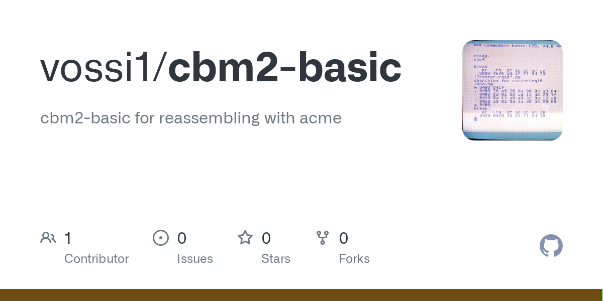

    The original source code of Basic is version 3a.
    You can assemble 600/700 and P500 version with 64,128,192 or 256kB with it.
    All eproms with later numbers (4, 4a) are identical. CBM labeled it only to fit optical to the kernal 4, 4a ;)
    In the basic are two small bugs: CBM used values as absolute instead immediate.
    I fixed these errors and my versions 4av for 600/700 and P500 in all RAM-versions are all here:
    cbm2-basic/roms at master · vossi1/cbm2-basic
    cbm2-basic for reassembling with acme. Contribute to vossi1/cbm2-basic development by creating an account on GitHub.
    You have to split the Basic binary in. two parts for your eproms.
