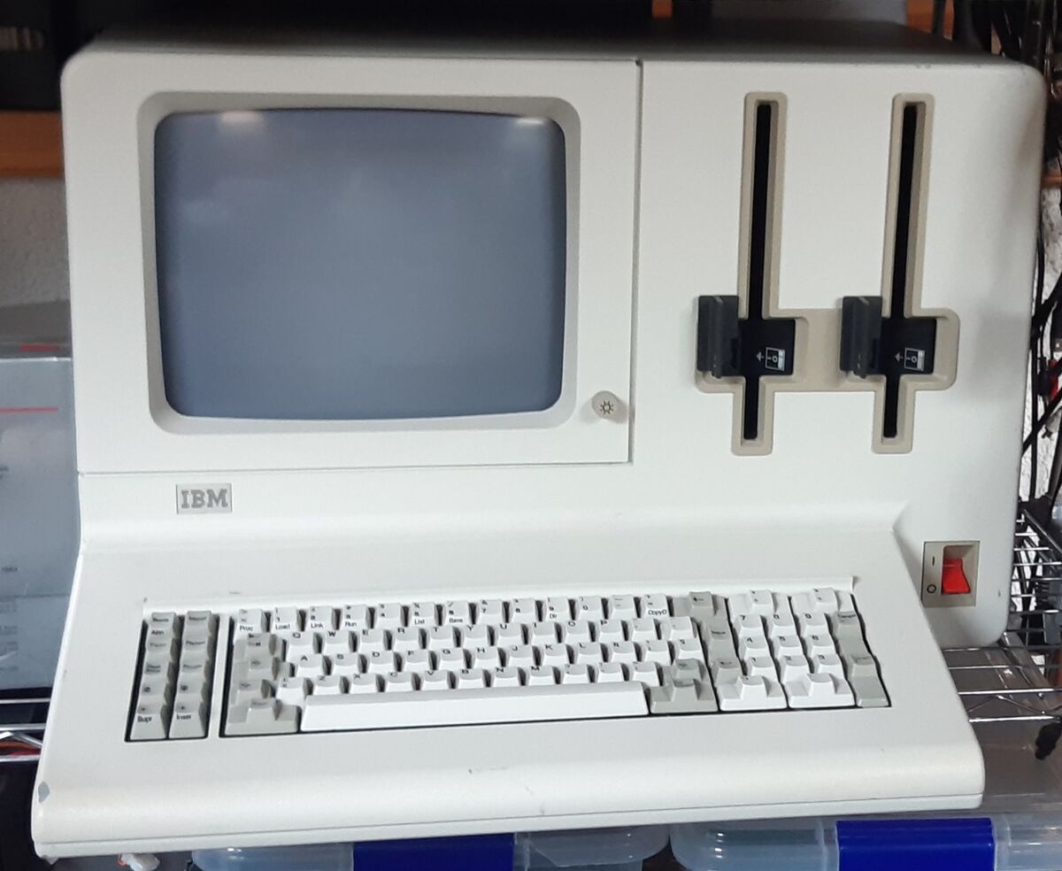

    Ich schreibe einen Artikel über den IBM System/23 Datamaster und nutze dabei mein bisheriges Wissen über den Computer, die verfügbaren Handbücher und meine eigene Erfahrung mit dem System als Referenz. Der Artikel ist noch in Arbeit, nimmt aber langsam Gestalt an. Falls Sie ihn lesen möchten, hier der Link:
    bitspassats.com
    Ich hoffe, er gefällt Ihnen!
    Übrigens... hat hier niemand einen Datamaster? Auch wenn er kaputt ist? Ich möchte Sie daran erinnern, dass ich Ihnen vielleicht helfen könnte, wenn er nicht funktioniert – in den letzten anderthalb Jahren habe ich Erfahrung im Debuggen von Teilen des Systems gesammelt.

    Today I have tested my first rom patch for the two non-banked memories of the computer. With some tweakings it worked as expected and the computer started its testing as usual:
    Testing the patch
    With this simple patch many System/23 will be easier to repair and many will simply return back to life if they issue is only with memories 02h and 09h. A solution for the rest of the ROS memories is underway and should be ordered in the next batch, as well as a ram memory replacement/upgrade and corrected and improved of the parts which came in this batch.

    For today, I have a probe to test the system - it is a simple probe that displays the number of test the computer is performing. It is so simple that it only contains the leds and the driver ICs to control them. As the Datamaster only displays the diagnostics on the screen if certain prerequisites are met, this device is useful for black screen situations.
    https://youtu.be/UrLsx8ZtCpY
    By removing the memory board, I have found that the testing stops at the last failed test.
    Good morning,
    I have ordered some prototypes for possible patches for this computer. Once tested, if they work as expected they would be able to recover broken units whose symptoms is just a black screen. For the time being, they would not work all the cases but only situations where RAM and ROM are involved.
    As detailed technical information has been lost, I am reverse-engineering it in order to document it. Some ports have been discovered, but most are still to be found.

    Also the TMS4132 is organized 2x 16k x 1:
    It's one of the most regrettable things in the world that I could only thank a post a single time only. You deserves, at least 10k!
    Yesterday night found pins 4 and 5 tied together and pins 2 and 15 also connected. This is the component I was searching!
    Thank you a lot!!!
    The truth is that I am not that sure to repair it now, but I will document and prepare some adapter nevertheless. I found it with a short-circuit and I am thinking to fully replace it.
